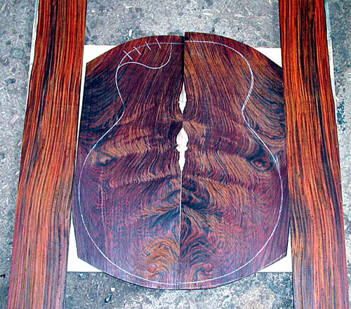

I had already decided on cocobolo back and sides. I had a rather wild back set and sides with a good color match that I had cut early last summer.
The back is actually the outermost two slices from the fancy log I showed on another post. It is mostly rift cut with the grain going through at an angle of about 45 degrees. A bit closer to quarter at the center, and almost flat in a small part of the lower bout. Lots of wild curl . But this log was almost totally dry even in the center when I cut it open, and these slices stayed stable even going through the normal seasonal humidty cycles here. I had hauled it around, left it in my truck for a week at a time, etc., figured that if it stood up to all that it would be OK . The sides are actually a better match than the photo shows, kinda poor light in the shop today.
This will by my standard small jumbo interpretation with a cutaway.

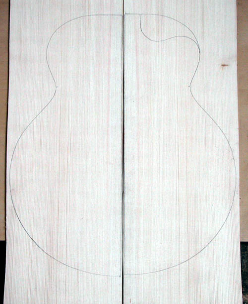

I plan to use one of my more even grained white spruce (Picea glauca) tops. The photo looks WAY too stripey. This is actually an almost uniform pure white color. I will probably use an ebony fingerboard and bridge, but I am toying with the idea of Honduran rosewood. I will use my typical bloodwood bindings with a flame maple and ebony lam.

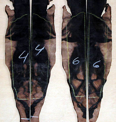

I will use one of these bookmatched figured ebony peghead veneers, but I might match the outer edges rather than the outline shown (this photo looks way too dark, the figure is actually very pronounced).
